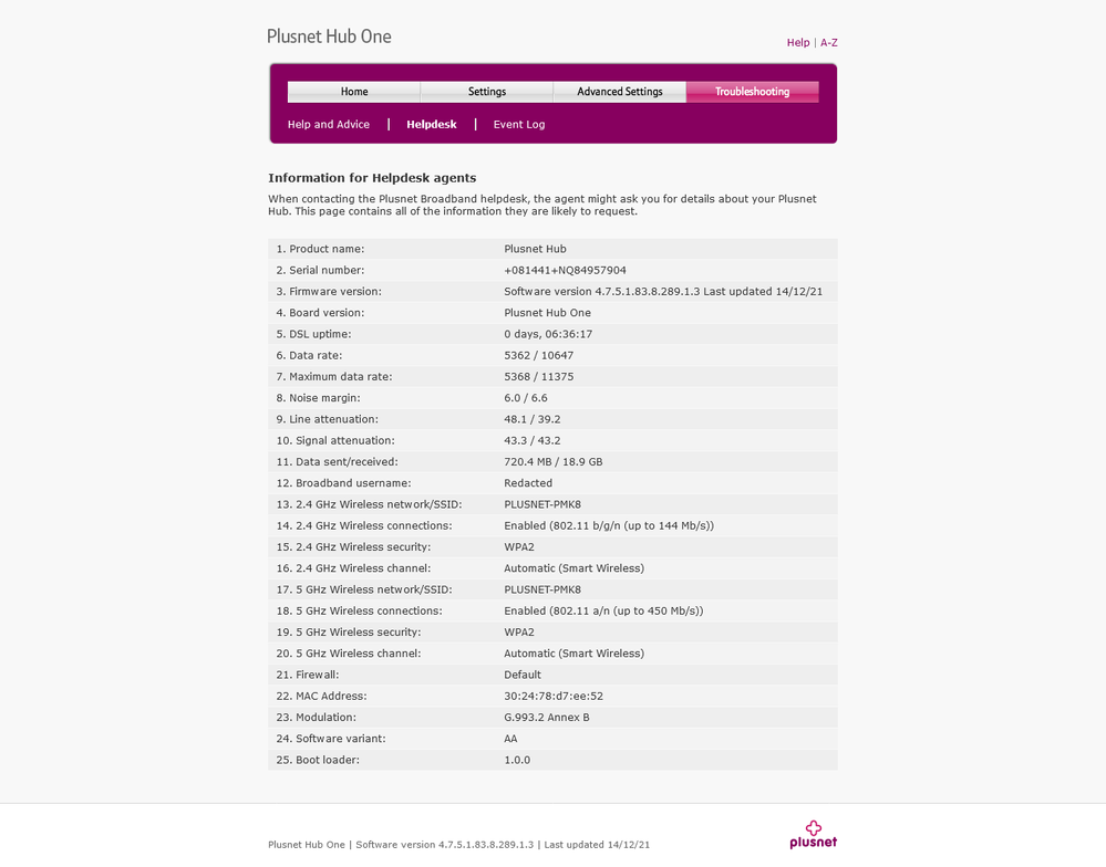

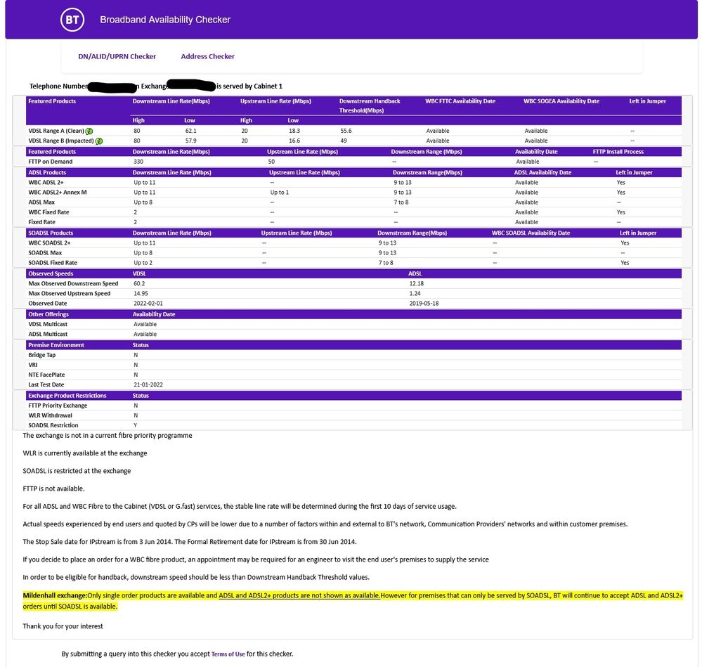

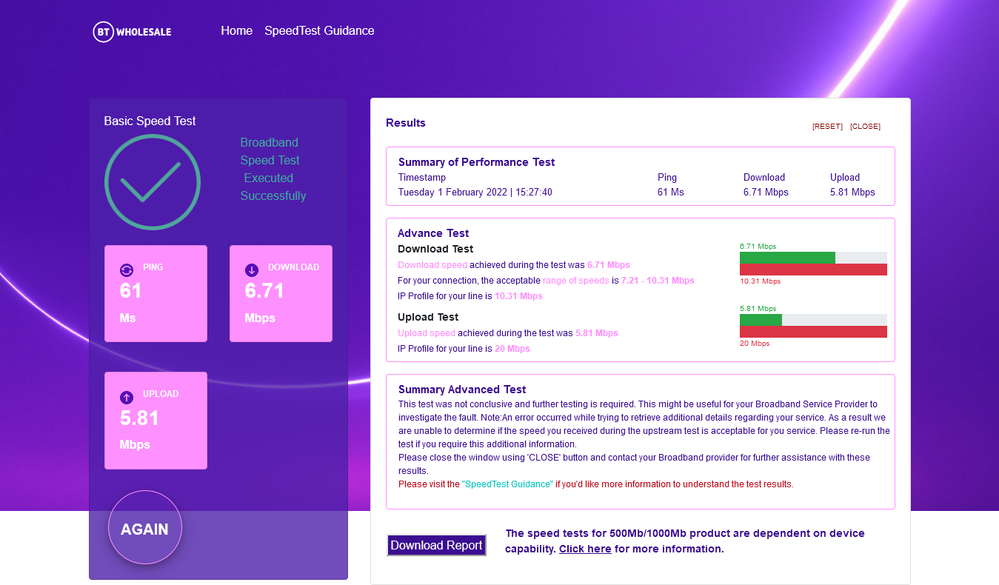

Hi yeah sorry for the lack of pics here they are hopefully. I have also hidden the plusnet email in the helpdesk tab, hopefully that isn't needed
Screenshot 2022-02-01 at 15-30-28 BTW Performance Tester.pngInkedInkedScreenshot 2022-02-01 at 15-25-56 BT Broadband_LI.jpgScreenshot 2022-02-01 at 15-33-59 Plusnet Hub Manager - Information for Helpdesk agents.png

@ryanmd  That info is useful - but extremely confusing. The BTW test(pic1) is reporting that your IP profile is only 10.1, whilst the Wholesale checker pic2) has reported a speed (today) of 60.2
Your Help Desk is reporting an uptime of 6.1/2hrs, probably due to the disconnections, although strangely your SNR is showing a healthy 6.6 on the D/S side.
My only suggestion is to report a fault, as indicated in my original reply
Have you carried out the Quiet Line Test - I suspect you have a voice circuit problem at the bottom of all this?

@ryanmd  I wouldn't bother testing with a phone, the router sync speed is ridiculously low and the line attenuation very high, it almost looks like a disconnect in one line of the incoming cable pair. There is a phone trouble shooting test on your user account under help and support (if you can access it) It would be worth trying that , it should raise a fault for you.

Thanks a lot for getting in touch. It looks like you've reached out on Twitter too. We've found a fault on the line, however our suppliers are telling us that the source of this is within the customer premise. Please go through the troubleshooting steps outlined by my colleague and let us know if you're still having issues.
If you are, we'll get this raised with Openreach, and will need to arrange an engineer visit. Smiley
