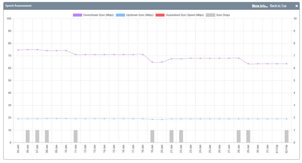

Thanks a lot for getting back to me @mexicano and I'm sorry to see that changing the internal speed profile has not helped. It's a strange one this, as looking at the speed graph, which I'll attach below, one could be forgiven for thinking that the line is banded, but it's not. The speed profile remains Downstream: 0.128M-16.5M with Retransmission (Low). Upstream: 0.128M-10M with no error protection but it's clear that sync speeds have been dropping.
Going forward, I'd like to arrange an engineer visit for further investigation here, as there's clearly something wrong with the line. I've just created a fault ticket on the account, please respond as to when  you'd be free for an engineer visit, and we'll get it arranged.
