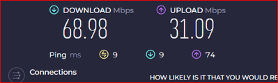

Upgraded to the FTTP 145 package but getting 60Mbps 67Mbs typically and 30 to 40 upload.

Speed is still similar, typically 67Mbs down and up to 40Mbps up.
My question. Do I have to do anything to get the estimated 145 to 160 Mbps or does Plusnet have to reset anything?

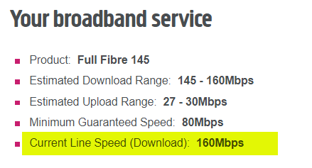

Log into Plusnet web portal.  In the Broadband tab, check the reported speeds reflect Full Fibre 145 service.

Re: Full fibre145 speed?
Thanks, the web portal shows

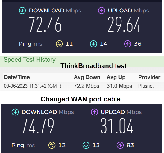

I tried some of the suggested fixes, AV off, MalwareBytes off and that made no difference.
My WAN lead was an OpenReach one that they swapped when trying to get the faulty modem working, so I unpacked my "returns" box and installed the new Plusnet modem WAN lead. Probably just noise or time, but it did increase by 2Mbps...
Top is Speedtest.net AV and MB's OFF
Middle is ThinkBroadband as above.
Lower is Plusnet WAN cable with AV and MB's all enabled.
I'll get out a "very old" Dell with an Internet port and try that this evening.
Thanks for your help.

hmm, 72-74 mbps looks awfully like 80mbps FTTC/FTTP speeds....
Were you previously on Plusnet Unlimited Fibre Extra (upto 80mb fttc)?
