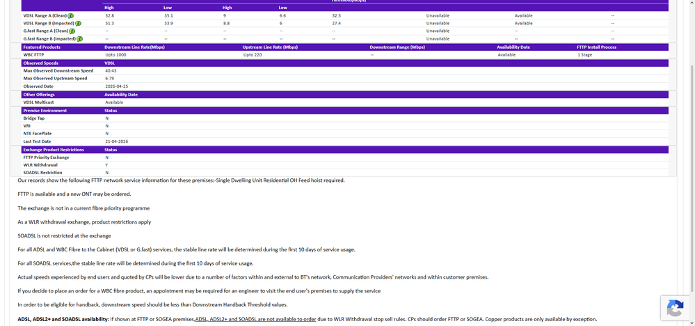

Have a look at the following
A good installer will try to work with you but it's often a case of the desirable against the possible. You need to look at every possible location for the internal ONT box. It needs to be near a power socket. As the router conencts via ethernet cable it can go anywhere you're happy to run said cable.
What does the following say about he FTTP install (below the results window) and what does it say to the right of WBC FTTP>

No - that's just the standard speed offered.
Can you post a screen image (after hiding personal details) or the results from the Checker, including the narrative below the window.

OK - it's showing as a "1 Stage" install but states "hoist required"
Basically OR are not expecting any problems, just a difficult access. It's one of those you'll not really known until the day of install as to what happens.
