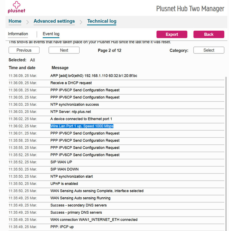

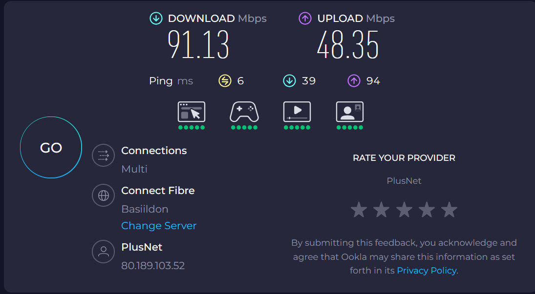

New router installed and technical log now showing LAN connection up speed 1000Mbps this is up from 100Mbps on the old device but no increase on LAN speed, WIFI still 300Mbps.
Just for info on how my computer is connected to the internet I'm using TP Link AV1000 Gigabit Powerline Model TL-PA7010 and TL-WPA7510
https://i.postimg.cc/YqsygKwm/2026-03-25-11-39-31.jpg
https://i.postimg.cc/6pS3D3xy/2026-03-25-11-17-30.jpg
Posts: 4,599
Thanks: 2,899
Fixes: 137
Re: Full fibre 300 Getting les than 100
@Ian1964
I was disappointed with that model of TP-Link powerline adapters, although they may connected to the router at 1000 Mbps the link speed was for me never for above 60 Mbps, I stopped using them.
I currently use TP-Link WPA4220 with TL-PA4010, I see speed tests of 95 Mbps in both directions with these.

Posts: 4,599
Thanks: 2,899
Fixes: 137
plusnet only guarantees the speed to the ONT, you would need to demonstrate that the speed with a device connected directly to the Hub is below your product speed.
As you have already stated WiFi devices speedtest is around 300 Mbps this suggests your product provision is fine.
Any third party equipment is out of scope.
You are using at cat5e cable or above at the PC end of the powerline adapter?
Have checked to see what the speed is between the powerline adapters?
Posts: 19,279
Thanks: 8,402
Fixes: 554
@Ian1964
My experience with those is that they'll max out at around 120Mb even when on the same electrical circuit. Put them on different circuits with RCD's and they'll drop down as low as 25Mb.
