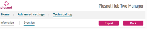

Posts: 4,864
Thanks: 3,181
Fixes: 145
Re: Full fiber - Connection /Data flow keeps freezing / pausing
@stevieklau
you can export the event log here
Click on Export, this will save a copy as a CSV file to the download folder of you PC. Attach the file to this thread.
A CSV file is more useful as this is the full history of your Hub rather than a snap shot offered by a screen shot..
