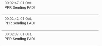

@MisterW  After a restart or a factory reset, the light on the hub turn green, then changes to solid orange and stays that way. It also remains solid orange when I try to connect after entering my username and password.
One thing I've noticed is a mechanical click coming from the Hub just after the reset, a split second before the ONT's LAN light turns green.
Hi @Dan_the_Van
Thanks for your support.
My logs all look like this:
Yes, I'm using the same username and password that I use to log in to my Plusnet account ([email protected]), and they work perfectly fine on the Plusnet website.
After entering my credentials and clicking Connect, I get a "Connecting..." pop-up, which changes to "Disconnected"after a few second - please see the screenshot below.
@Baldrick1 Thanks to you as well for joining the discussion.
Yes, I'm using exactly the same credentials ([email protected]), as I use to log in to my Plusnet account when trying to connect the Hub to the network.
The funniest thing is that yesterday morning I received a text from Openreach saying an engineer would be coming today between 8:00 am and 1:00 pm, before I'd even reported the issue. I replied "NOT" to decline the appointment, but this morning I received another confirmation saying the engineer was still coming to install my FTTP, even though it had already been installed on Monday.
On top of that, Plusnet have sent me a new Hub, and I also have another engineer appointment booked for Friday. This one was arranged during my call with PN yesterday.

Thanks for sharing the information.
You should be seeing these messages
PPP: Starting PPP daemon
PPP: Sending PADI
PPP: Received PADO
PPP: Sending PADR
PPP: Received PADS
PPP: LCP up
PPP: CHAP authentication succeeded
Repeated PPP: Sending PADI suggests there is no uplink to the plusnet network. Most likely an incomplete installation.
Ok, that does sound like a BTw circuit build problem or as @pvmb suggests , the ONT not registered correctly. In reality both are effectively the same , your connection to the Openreach/BTwholesale network isnt configured properly and it will need an Openreach engineer visit to fix it.
