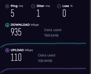

Using Wifi, sat in the same room about 8 ft from the router with no obstruction or interference from other wireless networks I get
Which is as much as you will get in optimal circumstances, move to another room and speed drops off.
In one of the upstairs room it's 'only' about 130Mbps.
Environment is everything.
I run an ethernet cable to the home office as that's where I need the speed and lower latency and get this:
