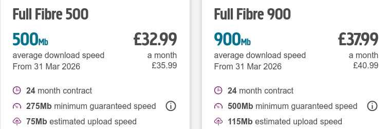

@ccxphoenix wrote:
... Current speed test is 512 down, 109 up - which is also weird as I've not lost any speed on the upload, which might point to a cable issue as mentioned above.
The fact that your upload speed is 109Mb probably confirms that your connection is still provisioned on Full Fibre 900,
and not accidentally gone to Full Fibre 500 as the upload would likely be limited to 75Mb if it had.
