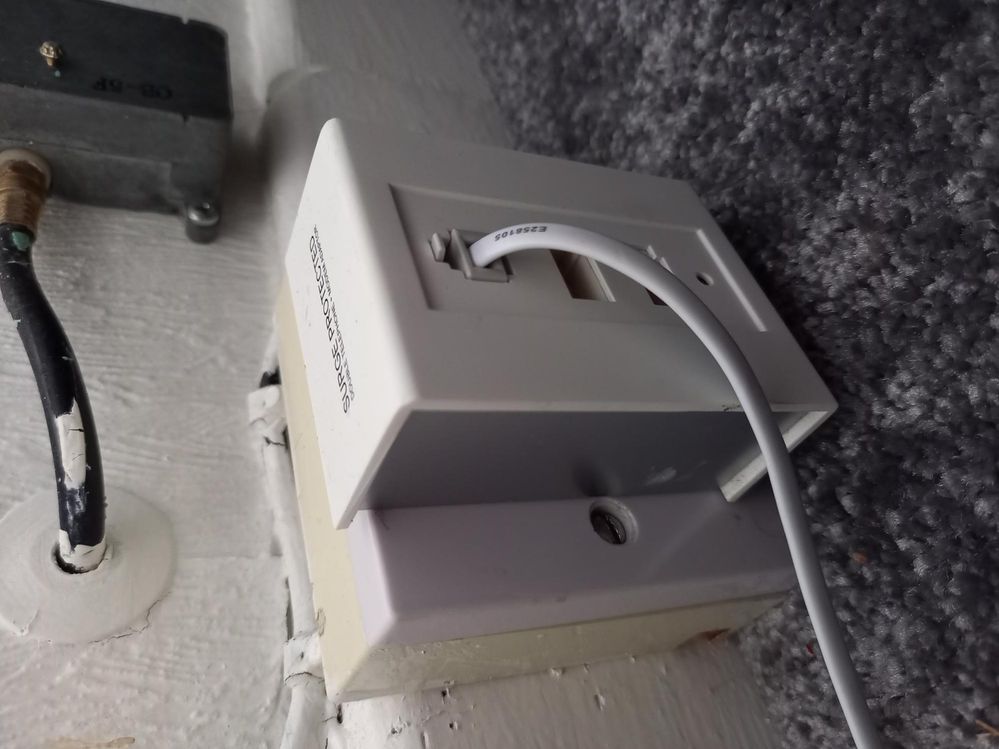

@jeneroo How old is the main socket? Could you post a picture? For your information, so far as I know, ALL master sockets have a test socket behind the faceplate.

Hi @jab1
As far as I know the sockets have never been replaced and we've been in the house for 20+ years. I've added the below photos. There are a couple other sockets in the house but they have been disconnected over the years, but also look like the below and are all attached to internal walls. This is the only line that comes in directly from the outside.
Posts: 24,873
Thanks: 8,907
Fixes: 380
Re: Fibre constantly cutting out
@jeneroo If you unscrew that socket in the second picture - it should be in there. If it isn't, you need Openreach to install a proper master socket.

OK @jeneroo . You need to get a proper master socket installed. Must admit it didn't look like one, to be honest - more like an extension.

It would be worth taking that faceplate off and inspect the rear of it and the wiring.  One wonders is the drop wire is twisted pairs?
@jeneroo If you trace the wire back through the house and to outside, can you find any junction boxes, possibly with another wire coming out?  Some old installations tee-off other sockets externally, so it would help to verify that this is a master socket.  See here ::. Kitz - BT Phone Sockets .::.
