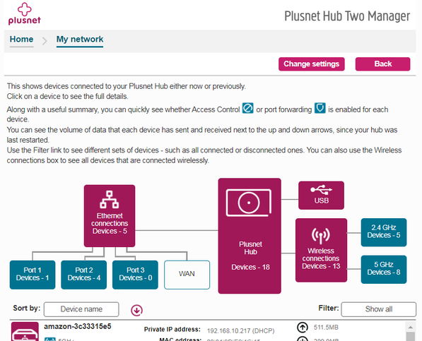

@quelquod
The Hub Two can list Connected and Disconnected devices, see
Using the Filter you should be able to display connected and disconnected devices.

@Dan_the_Van
Hi, yes I understand that but what I meant is that it's not very accurate sometimes or has lots of latency. For instance I've been playing music from 1 of my NASs all afternoon but it still shows as disconnected and my wife's Kindle shows as connected even though she last used it at lunchtime. So it's not always too handy when you're trying to identify an unknown device.

The Hub two has some quirks and can show a device connected or disconnected when in either state. An "Unknown device" could be one with a 'randomised MAC address'.
