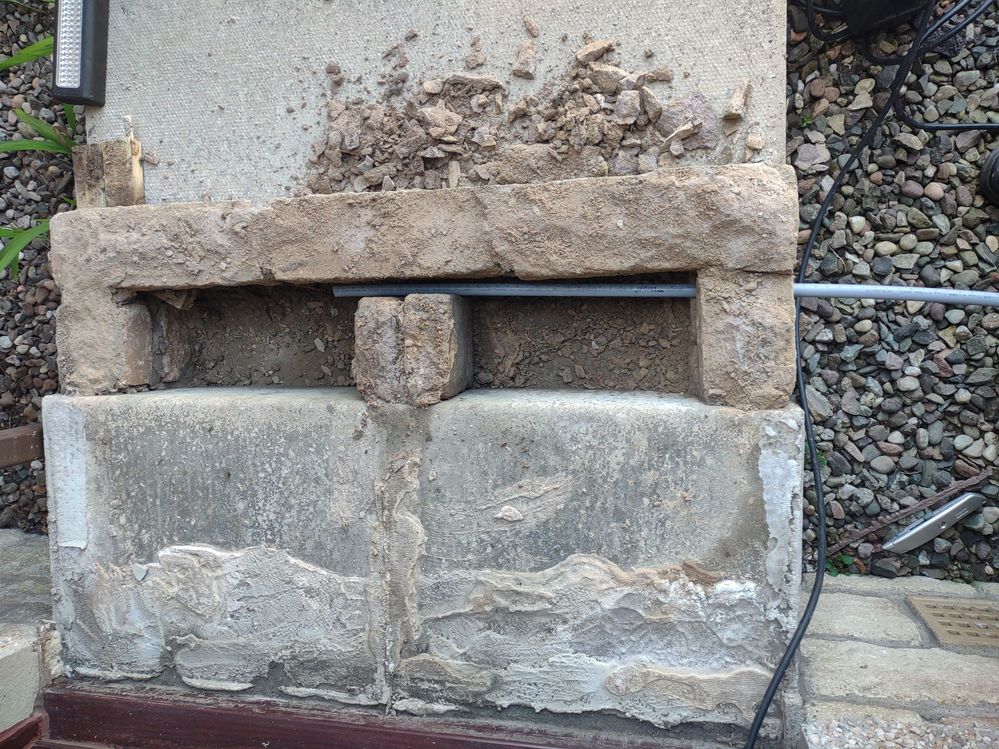

Running the fibre cable in a discreet manner entailed some preparation before the Openreach visit. We partially dismantled the doorstep and ran a grey plastic water pipe through the doorstep and rebuilt it.

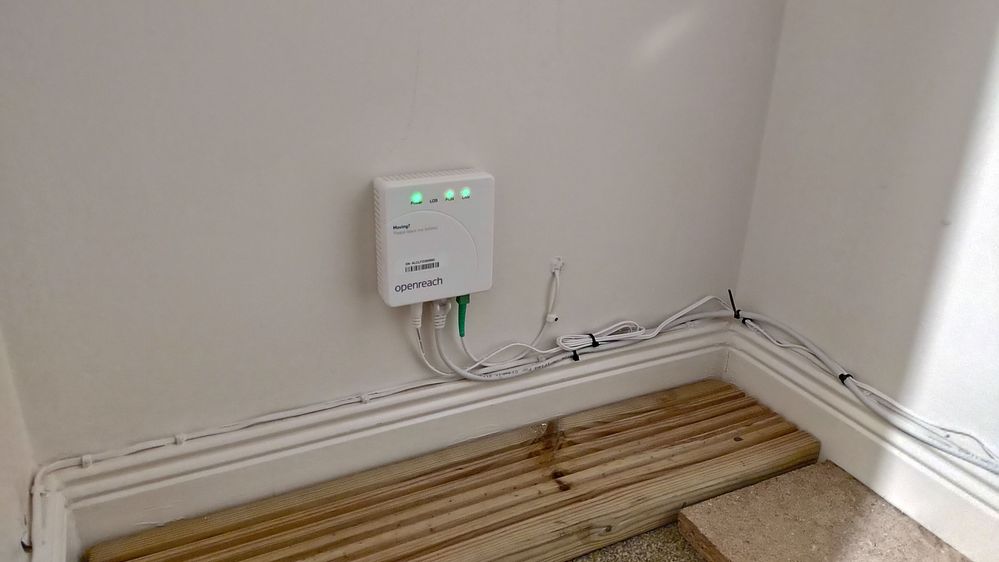

On the install date the Openreach engineer ran the fibre cable through the plastic pipe to the other side of the step. He fitted the ONT inside a built in wardrobe, at our request.

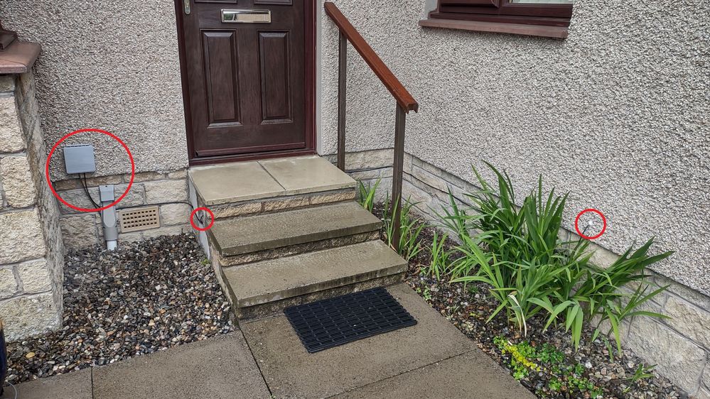

The photo shows that the existing Openreach cable duct is to the left of the doorstep. However, we needed the fibre cable to enter the house to the right of the doorstep (without running unsightly cables on the front of the house. Have circled the cable duct, the plastic pipe and where the fibre cable enters the property.

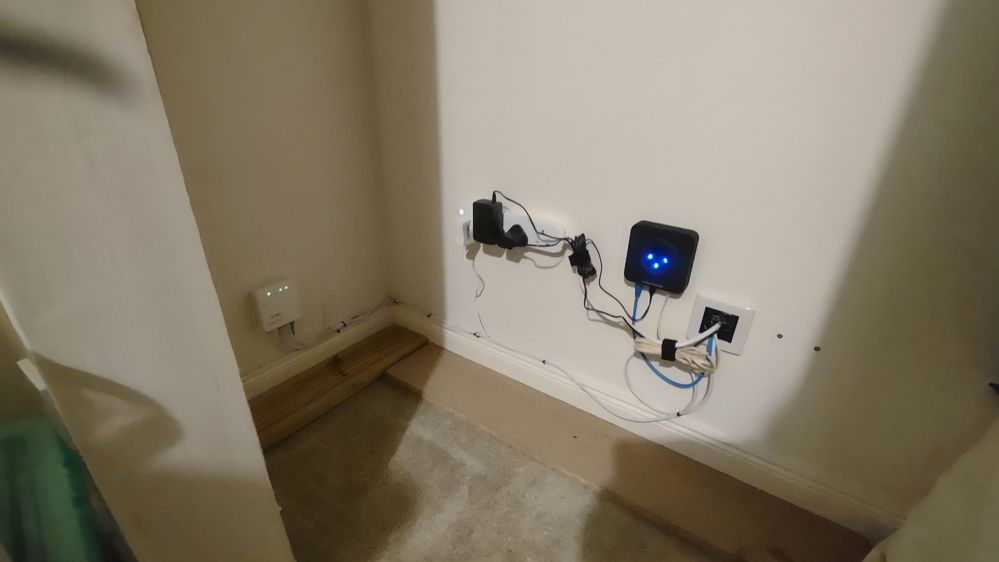

The photo shows the ONT, a 4 way surge protected cable bar, the Grandstream HT801 analogue telephone adaptor. The computer and router are on the other side of this wall and various power, Ethernet, and phone cables go through the wall (via the brush plate). The blue Ethernet cable feeds the ATA from the router. The white ethernet cable runs from the ONT to the router. As the cable bar is permanently turned on, the power supply for the router is plugged in here too.
