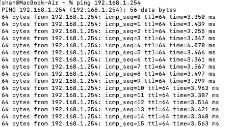

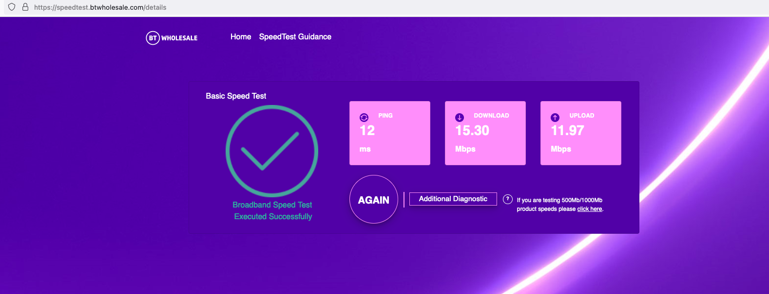

It arrived today and we set it up around 3.30pm. by 4pm it was doing the same as the old router and reconnecting every 1 minute or so, and the speed test was terrible (<5mbps 15:46 and 15:56 in the screenshots attached), if I could get the speed test to run at all.
Swapped back to the old router. worked ok for 20 or so minutes and now constantly disconnecting, every minute. so posting this from me mobile tethering.
May swap back to new router, as it does not seem to matter which is plugged and then we'll pray it stablises.
So far we've had:
- first engineers visit- the master socket been replaced with intergrated filter, modem cable replaced, various tests run - still unstable
- second engineer visit- the wiring from the new master socket to the street cabinet has all been changed- still unstable
- updated the firmware of the old router to the latest via @bobpullen
- the old router has been swapped for a new one with the older firmware
and still the internet is not stable at all and still not getting the guaranteed speeds. Video calls are stuttering as ever. Attached screenshots show the disconnect issues with the new modem, and the speed tests. (<5mbps 15:46 and 15:56 in the screen shots attached). some speed tests are with the old modem i.e. the latest (16:23 to 16:29).
The old modem is the older speed tests, ran some of these after 1am a few days ago to make sure the time of day was not affecting things- seems worse off after 1am!
what can we now try? the second engineer suggested switching to FTTP, seriously considering this as the current broadband is just not usable and causing lots of stress in the house. I've had to tether and buy 2x10gb data addons from EE to take part in work meetings- about £15 each time.
