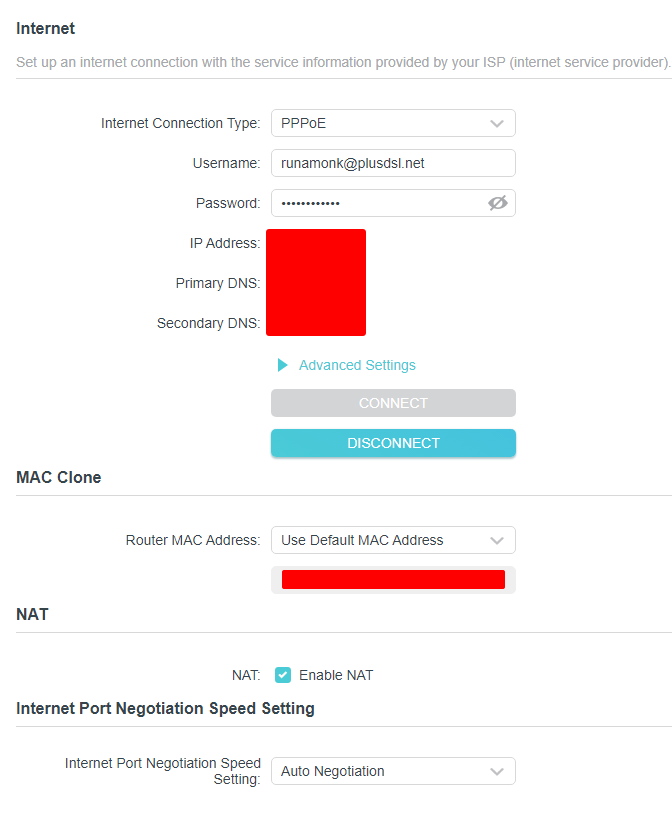

Sounds like you need to swtich/setup PPPOE like below.
