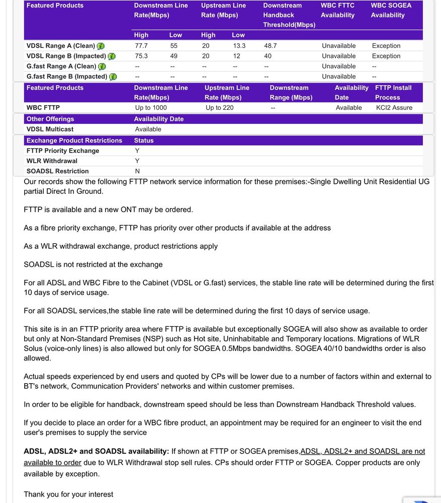

BT Check results as follows:
Our records show the following FTTP network service information for these premises:-Single Dwelling Unit Residential UG partial Direct In Ground.
FTTP is available and a new ONT may be ordered.
As a fibre priority exchange, FTTP has priority over other products if available at the address
KCI2 Assure

Its not a straight forward install.
KCI2 means a survey is required and then digging to lay a duct. While there is some leeway as to where the CSP goes it will probably be near the trench.
The ONT doesn't have to be on the other side of the external wall but is generally limited to the room in which the cable enters the property. It is possible to run the cable along the outside of the wall. I'm afraid you just don't know until the day of install or, in your case, if you manage to speak to the surveyor. What ever happens you speak to the installer on the day (and / or the Civils team that do the trenching).
KCI2 Assure
Is 'UG partial Direct In Ground' followed by either 'soft' or 'hard'? This might give you a clue to the original surveyors route. You can be pretty sure that out of the choice they will not dig up your drive or patio if it can be avoided.

@Baldrick1 UG partial Direct In Ground doesn't mention hard nor soft afterwards.
I'm guessing but they'll probably dig across the driveway as it is gravel and attach the CSP near the side of the house (right side of driveway) - and then run a cable along the front (similar to the red wire in my diagram) to the ONT.
