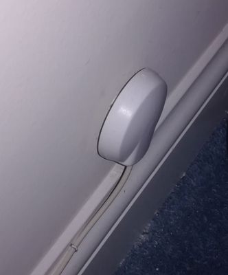

Having thought about it I'd guess the narrative simply means that the local install team didn't check the house ducts and the note tells the house installer what duct to expect.
I'd agree with @jab1 that OR wouldn't run the cable round the outside of the house - they might go under a window to bring it in on the other side but without going round a corner.
The actual install will depend on the engineer on the day. Generally they tend to work with you if it's possible. If your master socket is beside the copper line entry point I would suggest putting the ONT there (if power's available). You can then run ethernet cable to where ever you want the router.
Shown below is my fibre entry point and a later one where it comes through the master socket. Note the ONT shown is an earlier model (when they came with battery back-ups).
