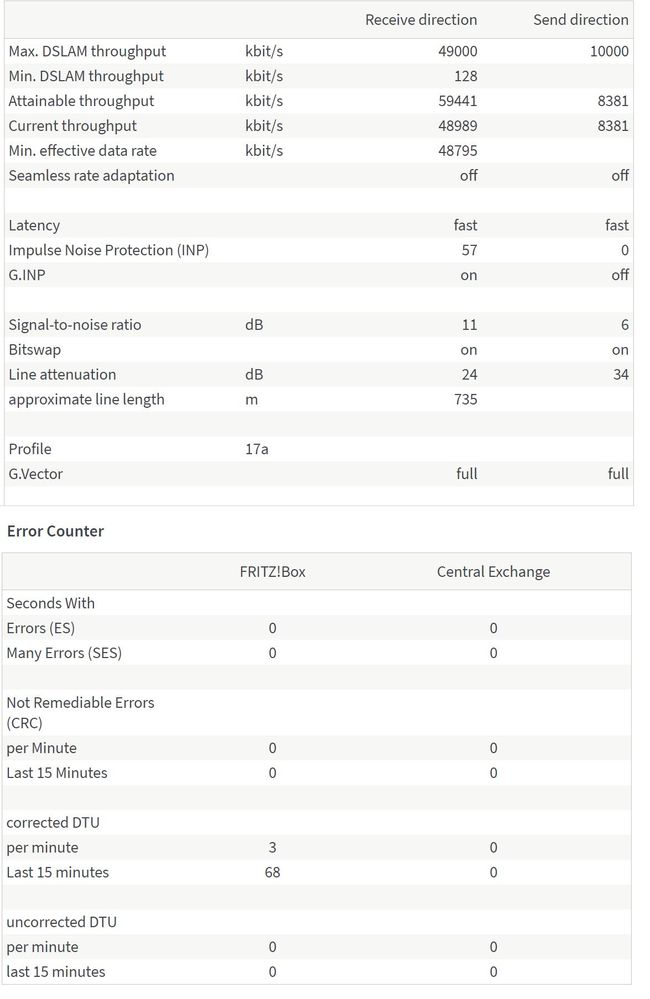

Until last Monday I was getting around 44Mbps / 8Mbps. I'm now getting around 22Mbps / 7Mbps. I also seem to have acquired a fixed IP as I can't make it change despite having disconnected completely and also re-started my session numerous times.
I notice that I'm not the only one experiencing a large drop in speed. Is there a general problem?
My current router stats-

Your router stats show you are getting 48Mbps.
You noticing that other people having problems is not surprising given that's what most come on here for - unless they are your neighbours it's unlikely there is a connection.

Yes, I'm synced at what is my normal rate in fact everything in my stats is how I would expect to see it BUT the speedtests that I've done on ThinkBroadBand, BT Perf Test and others all return about 22Mbps download. Until the day before yesterday it was consistenly 44Mbps (I'm on 55/10). I suffered a 20Mbps loss of measured download speed overnight.
It's almost as if I'm stuck on a failing gateway but my old habit of gateway hopping isn't working and I don't understand why my IP isn't changing after what must now be a couple of dozen re-connects.

My understanding of DLM is that it is repeated loss of sync that causes problems. Am I wrong? Does dropping the ppoe session and re-connecting trigger DLM intervention? I have actually re-booted my router i.e. lost sync as well a couple of times but that only since the drop in speed. The SNR I am seeing is exactly the same as it has been for weeks now, is that not a measure of whether DLM intervention has occurred?
If I lose sync then a re-connection takes approx 7 minutes. If I force a new session it takes between 1 and 2 seconds. In the past, more often than not a new session meant a change of IP but this has changed recently.

Am I correct in thinking this is a Fritz!box router? What is your current uptime?

p.s. - Yes it's a Fritz!bOX 7530 and my current uptime is just a few hours. Previously it was around 14 days. Forcing a new ppoe session doesn't affect the sync uptime.

@Mustrum The 'attainable' throughput is somewhat higher than the 'current' - is that indicative of a problem? I withdraw my comment re: the SNR, as it may be a red herring - it is the same as mine, and I am running at near max speed on speed tests.

@jab1  no, that is normal, although the difference to the actual sync speed may indicate a bit of banding.
But the lower speed test suggest congestion, either in the home or maybe exchange, but it would not be consistent..
No much detail shared so far, so will see what else is forthcoming.

p.s. I'm sure that my connection is banded (as I understand it), the estimated line length in my stats 735 metres is correct within a metre or two. The long re-sync times I see are down to the fact that my cabinet has vectoring, according to one of the engineers I had in a while back.

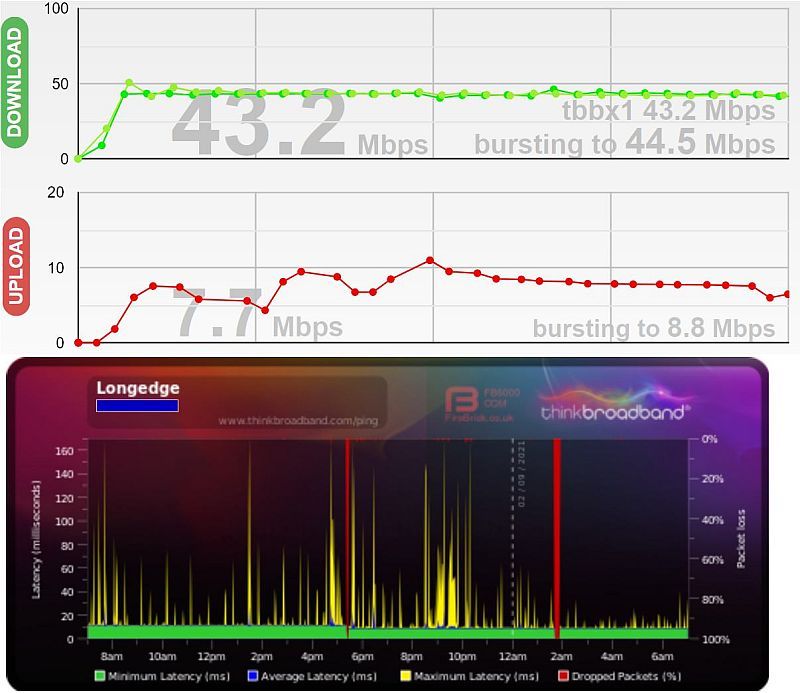

Just tried - 22.6Mbps / 7.3Mbps interestingly the upload is pretty much normal.

Service dropped around 01:30 hours and everything back to normal now.
