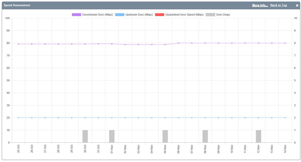

KBD
GEA Test Detail
Circuit ID NA Service ID
Test Outcome Pass
Main Fault Location OK
Sync Status In Sync
Downstream Speed 80.0 Mbps
Upstream Speed 20.0 Mbps
Appointment Required N
Fault Report Advised N
NTE Power Status PowerOn
Voice Line Test Result Pass
Cross Talk Not Detected
Estimated Line Length In Metres 157.6
Upstream Rate Assessment Very Good
Technology VDSL
DP Type Internal
Profile Name 0.128M-80M Downstream, Error Protection Off - 0.128M-20M Upstream, Error Protection Off
Time Stamp 2021-11-09T00:15:00
Parameters MIN MAX AVG
Down Stream Line Rate 79.9 Mbps 79.9 Mbps 79.9 Mbps
Up Stream Line Rate 20.0 Mbps 20.0 Mbps 20.0 Mbps
Up Time 781.0 Sec 900.0 Sec 899.6 Sec
Retrains 0.0 1.0 0.0
