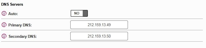

My Hub2
The reason I don't accept "Auto" on the Hub2 is that the DHCP server on the hub2 decides that the Hub2 is going to be the de-facto DNS server for everything that it assigns an IP to - if it is set to AUTO. Which (IMO) is a tad bit broken.
With non-AUTO and primary and secondary DNS manually set on the Hub2 all clients on the LAN receive DNS servers which have been manually set (i.e. .49 and .50, rather than 192.168.1.254)
My thoughts.The source code that underlies that possibly goes back to consumer grade home routers where the consumer could exercise local control on a subset of DNS (i.e. blocking certain domain names via the local 'router'). Previous versions of Plusnet supplied routers have acted in the same manner.

What do you think you actually accomplish by changing the default settings? Your configuration uses the same IP subnet for both DNS servers giving a high probability that if one is inaccessible then so is the other.
Hub 2 passes all of GRC’s DNS vulnerability tests.
Re: DNS down - set your DNS servers manually
@greygit1 wrote:
With non-AUTO ... ... ... all clients on the LAN receive DNS servers which have been manually set (i.e. .49 and .50, rather than 192.168.1.254)
@greygit1  -  Assuming what you are saying is true, why would you want to do that ?.
Every router that I've had for the last 20 years has had local DNS caching of all the previous DNS replies it has been asked to lookup by the network clients - therefore you should want to have the LAN client's DNS pointing at the router to get the speed benefit from accessing the local DNS cache.
If you're forcing router DHCP to handout external DNS server addresses to all of the LAN clients, then you are intentionally bypassing any router DNS cache, causing something like a 50x latency slowdown on each and every DNS request, and a huge increase in the number of external internet DNS requests+replies, unnecessarily using up your connection bandwidth.

@Anonymous It would be great if you could get the router to set itself as the primary DNS and something else as the secondary.. that would be far too clever and failure-tolerant, though. 😉
I totally get what you're saying about the router serving as a local DNS cache, I'm just now in a quandary about what to do... Do I want speed or stability? Seems I can't have both. Cry
Unless I wanted to run my own DNS server.. I'm not sure if I'm that invested emotionally. 😂
