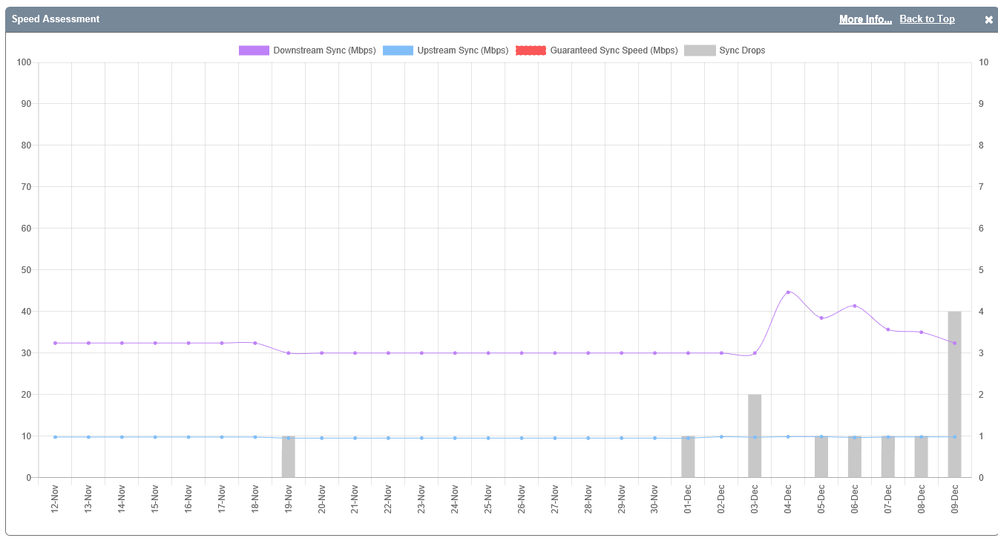

Hi all,
Having been through the usual box ticking of eliminating cable/router/socket/filter etc possibilities.
Raised a ticket: "DLM profile banded to 30Mbps, DLM profile reset requested" was done on Thursday, marked as Speed Fault Resolved this Monday.
Plusnet package:
  • Minimum Guaranteed Speed: 34.6Mbps
  • Current Line Speed (Download): 31.2Mbps
Speedtest result: 26.24 Mbps, pretty consistently around the 26-28 mark before and after the fault
https://imgur.com/a/pdN5VRM package/speed test result/broadband checker, tests done wired into the router.
It's an improvement from the dip below 20Mbps I experienced but a way off the estimates, worth pursuing or is 26-28 what my line can actually supply in reality?

Thanks a lot for reaching out and I;m sorry to hear that you've been having problems with your line speed lately. It appears there's a few things at play here. The first being that your connection is routed through L2TP, given the static IP, meaning your speeds are influenced by the connection profile on our end, which was previously banding the line at around 32Mbps, I've just reset this to the highest available, so this might and could help.
Please can you run a wired speed test and let us know how you get on?
If your speeds are still below the minimum, let me know because the sync speed isn't reaching the banded profile speed at the moment, indicating a physical issue on the line. If that's the case, we'll get it raised with Openreach for further investigation. Smiley

If the profile was banded at 35Mbps, and you were getting 35Mbps, I'd raise a DLM reset, however with the line syncing below that, it indicates a possible fault on the line. Have you tried plugging your router directly into the test socket at all?

I've got stripped it all back to basics, the hub one is plugged directly into the test socket (has been for a while now). Just taken the phone splitter out of the equation as well, which has edged the result up to 28-29Mbps.

A very helpful openreach engineer did make the appointment today, replaced the master socket, and I believe repaired the line at the cabinet and did a lift and shift.
Our connection speed has improved but it was fluctuating a bit during his testing. He said to let him know if the speed stays stable as there were some possible issues he didn't have time to resolve then.
He did wonder if the 10Mbps difference between what he was getting at the master socket and what the throughput was might be improved by a new model router/modem.

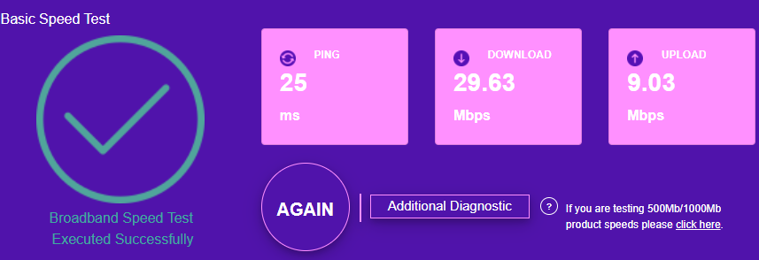

The last 24 hours it's been about 34Mbps up and 9Mbps down, no drop in speed so far. If it stays at this level i'll be pretty happy as that's the fastest it's been for a while.
I'm not sure why plusnet keep changing the details of the speeds on the account details page? Gone from overestimating to underestimating, and shifting the guaranteed minimum speed.
Yesterday was interesting, I had been using a Hub One but after the work at the cabinet the Hub One was causing errors on the engineers tests. So swapped back to the HG612 combo that I'd kept in the cupboard, which didn't return the errors of the Hub One.

The download has dropped to 29-30Mbps over the weekend and the profile on the account page has been changed? Could you check this please? Thanks Smiley
