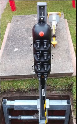

Your photo certainly looks like FTTP equipment but would require a Customer Connectorized Terminal (CBT) or Distribution Point (DP - as I call them) further up the pole. These do the individual property connections. The following is an 8 port underground one.

In post #12 I should have said Connectorized Block Terminal (CBT). If you have DP's further up the pole then FTTP is coming to your property. If you count the number of ports / nodes they should exceed the number of lines from the pole.
You need to keep an eye on the following. When it shows WBC FTTP in the left hand column and Available over to the right then the circuit is live. https://www.broadbandchecker.btwholesale.com/#/ADSL
I picture I posted is from my house (over 20 years old) chamber. It's the system used in all underground supplied lines where the ducts are usable. The 8 ports served 7 properties. When a service is requested OR run a cable through the duct to your house and plug it in to the CBT (hence connectorized). For my house they drilled through the wall but later installs from this chamber went in via the existing copper line entry point.
