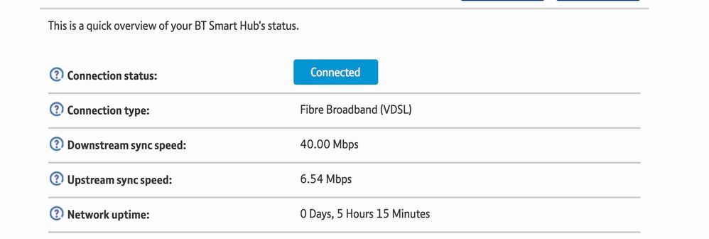

In the meantime, I thought I'd share this with you incase it helps with diagnostics - Had a re-connect at over 40 during the night, fully expect it to drop to the mid twenties by lunchtime.

Thanks for getting back to me Rob and cheers for sharing the stats.
At this stage, I don't think it'd make much difference, but let me know how the engineer visit goes. Smiley
