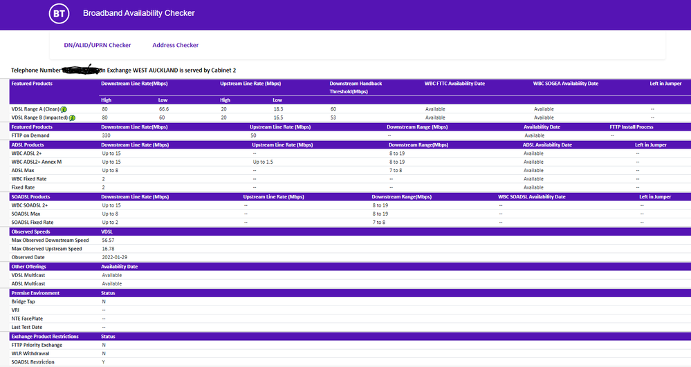

So, I have signed up to the 80/20 Fibre Max offering from Plusnet, and my line according to the wholesale checker is showing that I should be getting speeds in the range of 80 to 66.6mb/s.  To date, I have never achieved these speeds and the speeds that I am currently getting fluctuate between 54.9 and 57.6mb/s (which I appreciate is above my guaranteed minimum speed of 54.6mb/s).  I would have thought that the GMS would be the exception rather than the norm.
I have had an Openreach engineer out who has said that the line is clear and that everything looks fine, he has checked everything internally and also checked the cabinet and said there was no issues there either.  The socket was checked with a device which showed three readings of 59mb/s, 54mb/s and finally 56mb/s (which is what I'm currently getting)
So from reading the wholesale checker output; it mentions a line handback speed of 60mb/s.... I was wondering what this is as obviously Openreach is taking the stance that the line is fine but nothing has ever reached even the handback speeds.

@jab1  The Op has already supplied the BT Wholesale checker result, he should be getting much higher speeds, possibly 80Mbps. The modem/router stats would useful to see. The fact that the OP was on Sky previously is not significant, all FTTC circuits are provided on Openreach equipment. It was only on Sky LLU (ADSL) where they had there own equipment in the exchange. I think the problem is more related to the sync speed rather than a congestion issue.

This is what the BT Wholesale checker shows in full
