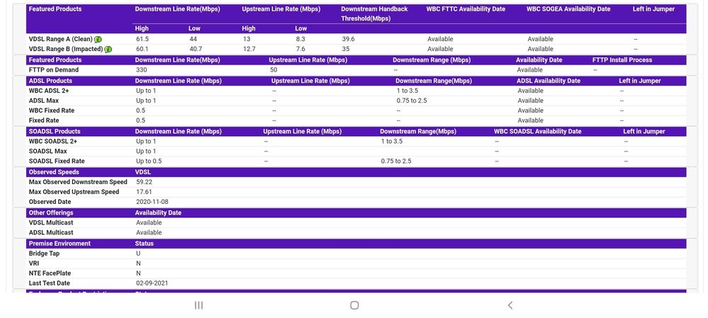

OK - just checking, because the help details are a little different. First things first:- can you please post screenshots of the results of these two sites? BTW Performance Tester and BT Broadband (making sure the phone number doesn't show)' Also check your phone line is clear - dial 17070, option 2 - after your phone number is confirmed you should hear nothing other than the periodic 'Quiet Line Test' announcement - any other noise, report a phone problem first.

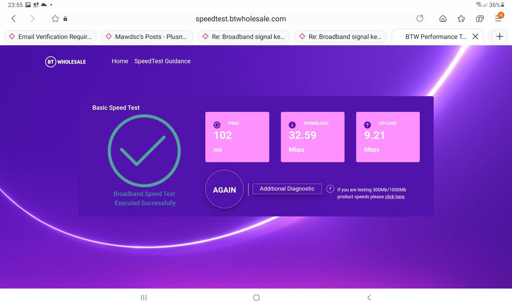

Just had to pull the plug to reset it but here are the results

22-09-2021 12:04 AM

@Mawdsc Those results clearly show you are on Fibre To The Cabinet. Sorry to keep asking for screenshots/data, but as a mere Community member, I can only advise based on what information you can supply.

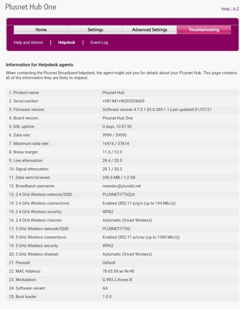

Next thing I need is your Troubleshooting page - looks a little like the below.

Line is quiet. Where do I get the other info from

22-09-2021 9:03 AM

@Mawdsc Thanks for that information. This needs Help Team intervention as you certainly have a broadband problem - the noise margins are a little high, but for some reason, although you look to be on the 80/20 product, your line has been capped at 40/10.

@jab1 The noise margin is high because the line can get higher speeds than 40mbps download and 10mbps upload but they're capped to this level by the Unlimited Fibre package they've ordered.
Upgrading to Unlimited Fibre Extra (80/20) will see the noise margin drop and line speeds going up.
There's no indication from the router stats that they're on 80/20, if you're looking at the maximum data rate, that's the maximum theoretical the line could achieve if the higher speed product was ordered.
