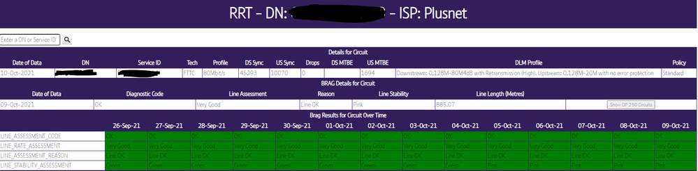

Going back I recalled a similar situation from March 2019. It wasn't fixed until an engineer was called to do a GEA test. It then got fixed along with an associated VLAN busy problem at the exchange which I did not understand.
Note the downstream speed highlighted in green in the file uploaded.

In addition, as of yesterday your sync speed has dropped to 45293 and the profile is "Downstream: 0.128M-80M 4dB with Retransmission (High). Upstream: 0.128M-20M with no error protection" giving a line speed of 43.2mbps taking into account the high retransmission that DLM's enabled.
Before yesterday you were on the profile "0.128M-80M Downstream 3dB, Retransmission High - 0.128M-20M Upstream, Error Protection Off" so the SNRM target we can see has increased by 1dB.
You're also not on a hot VLAN as there's no congestion seen at the exchange.
We have absolutely no control over your sync speed or SNRM. All we can do remotely to a FTTC line is request a banding indicated by "0.128M-80M" on a GEA or RRT test reset but in this case you're on the highest banding already.
As our testing isn't showing any issues with the line and you're within the estimated speed range for your line, an Openreach engineer sadly wouldn't investigate as your speed's within expectations. Appreciate you had higher speeds in the past, but that doesn't mean you'll always get that same speed.
I am though interested in the sync speed of 68mbps you were getting yesterday morning. Has anything changed since then?

Hello again and thanks for straightening me out. I note that the 'Line Stability Assessment' on the test you attached changed to 'Pink' on 5th October. I'm not aware of any interruptions on that date - the power cut was 8th October. But it is what it is I guess.
So... I think I've taken this as far as it can go and my thanks to all who contributed.
