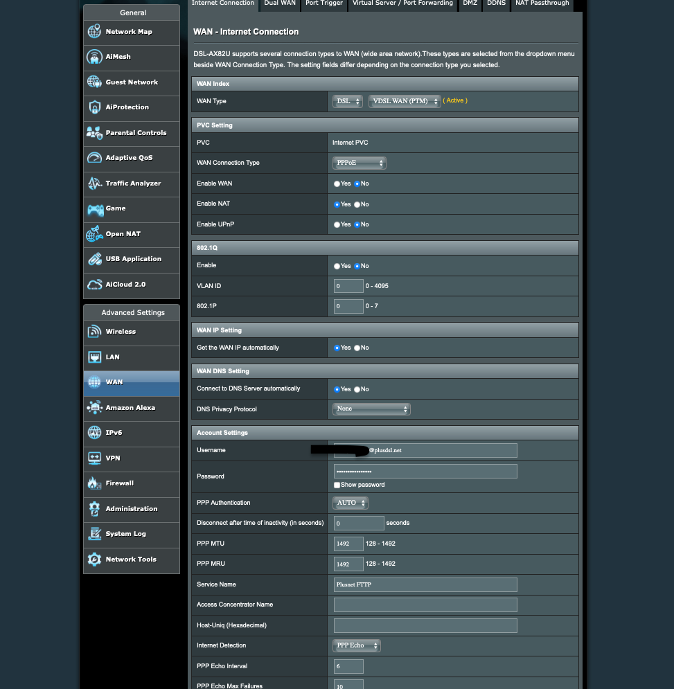

Sorry guys still no luck, here are my setting.
Under the WAN Index (WAN Type) there is no option to change from DSL.

Re: ASUS AX82U full fibre settings
From this topic that had the same problem - https://community.plus.net/t5/My-Router/Asus-DSL-AX82U-Router-not-connecting-to-Internet/m-p/1899245...
The difference between their working connection and yours is "Enable WAN" is set to "Yes"

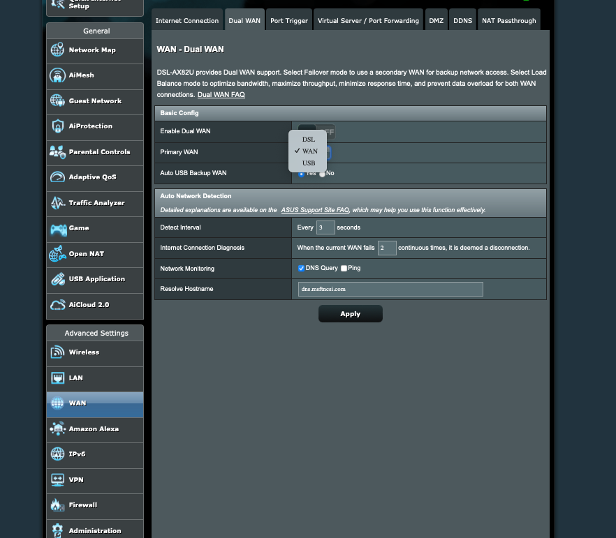

@R2-D2   looks like your other WAN interface has not been set up.
You could try enabling the Dual WAN and set it up from there, or set it up from the start at the Quick Internet Setup.

Went into Dual Wan and changed Primary to WAN Config
Thanks everyone.
