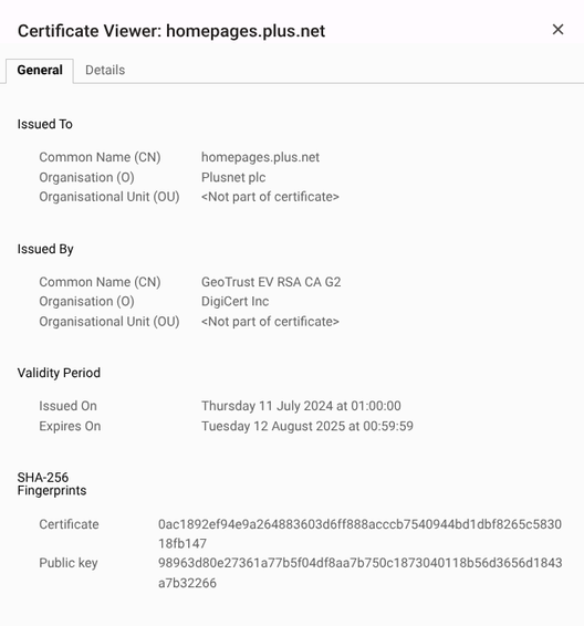

This is what I see when I try browsing to your secure URL 🤔

@bobpullen, it looks like it depends on which server you get connected to: https://www.ssllabs.com/ssltest/analyze.html?d=homepages.plus.net

@bobpullen, if you ignore mismatched certificates, the certificate coming from 212.159.9.91 was renewed yesterday for repository.plus.net, and doesn't include homepages.plus.net
Thanks, that's conclusive enough.
I'll elbow some folk in the ribs 😉
Re: homepages.plus.net certificate
28-05-2025 2:04 PM - edited 28-05-2025 2:11 PM
@longtimeuser - should now be sorted. Shout if you disagree and thanks for flagging.
28-05-2025 2:43 PM
That seems to have fixed it. Thanks for the speedy response.
