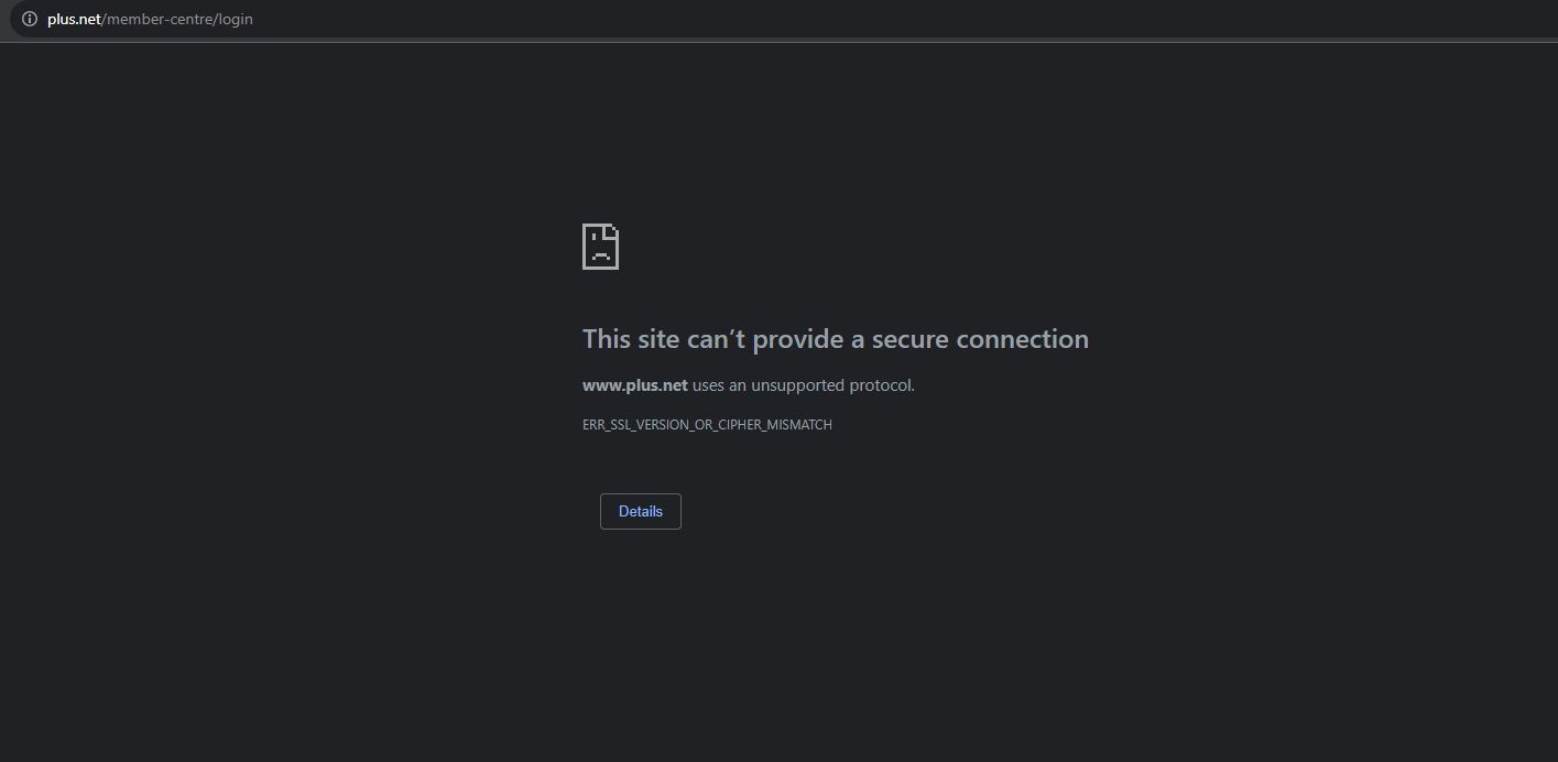

Is there a problem with the Plusnet site at the moment?
All I get with any page I try to Log in to is this:

Re: PN main site
@ColinXSD Which browser, on what kit, are you using?

Re: PN main site
@jab1 Chrome on a Windows 11 PC,
also checked on my Android Phone and get the same message.

Re: PN main site
It is a result of Chrome changing some settings. There are a number of topics on this subject.

Thanks @jab1, I'll try the uninstall/reinstall then.
I tried using Edge and that worked.
I have never had any problems like that with Chrome before but have with Edge, looks like I may have to find another Browser?

Re: PN main site
DO NOT use that option - as Bob Pullen says in the currently last post - there will be a new cert issued to resolve the current problem this week.
