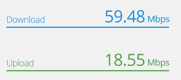

Amazingly that actually has worked.
Speed I am getting to the router from PlusNet
Speed test results on PC upstairs
When I hook up my TV Box to the switch my speed drops down to about 45mbps. Which I do understand if you are having more than one device connected to the switch.

Is there a more accurate way to test your download speed? As I don't really trust these speed test sites as I get all sorts of different results ranging from 7mbps - 59mbps.
edit: currently downloading a game and it is downloading at around 6.8 - 7.16 mbps. Much bigger improvement from wifi which downloaded the same game at 2.3mbps max
