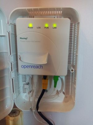

Found the pictures I was looking for.
The first two are from an install in NI. The outer shell covers the original master socket wall box where the incoming fibre cable is. The green "pigs tail" connector is then splice onto it. You can see the fibre cable wrapped around - excess cable is needed to allow the fibre to reach the splicing machine.
The last picture is actually off Google but the poster stated it was like their install which they had then covered up with office furniture.
