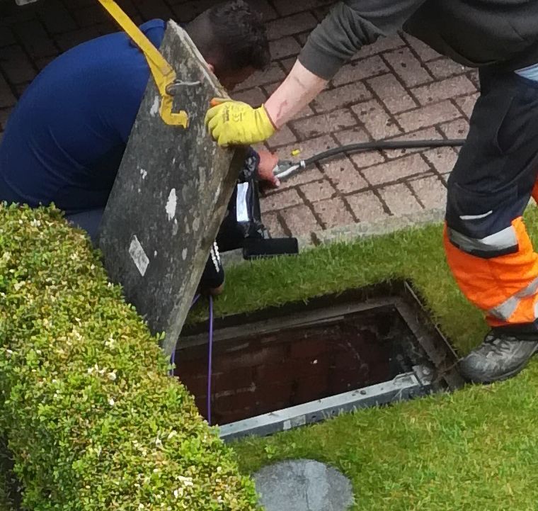

This picture shows the chamber service my house.
You can see the existing copper connections left in place so services continue to work as normal. The CBT has 8 ports to service 7 houses. The bull "pull ropes" are where they checked individual house ducts - if clear they left a pull rope for the house installer.
Since this was taken CityFibre have added 7 ducts to the chamber for their network.

The CityFibre network is slighly different. They have a cabinet at the top of the street which connects to their own backbone network. Then then use the OR ducts to run a separate 5mm duct to each property and blow the fibre optic cable through the duct.
You can see one of their ducts in this picture. I think there were testing the duct was clear all the way back to their cabinet.
