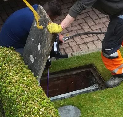

@jgb
Thanks for the explanation.
This is the CF fibre in the OR duct serving my house. They would have 5 or 6 mtr to run to install at my property.
