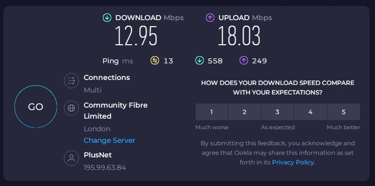

I've avoided posting in the broadband or full fibre forums in case i've got it wrong! - But I'm sure we're on FTTP?
So what gives with this staggeringly low speed? - Rare to see an upload speed thats faster!
screenshot-1604
With an upload speed that's faster by 50%, maybe i should setup my own little datacentre? lol.

Your ping stats look horrible, but if you are on FF, something certainly is wrong. What does the ThinkBroadband speed test say, just for comparison?

Well you'd know if you were on FTTP. Openreach would have been along to install it and you'd have an ONT in the house, connected to your router!
Sight of the router stats would be useful...

@7up - Hi, I've tested your connection and expect you to get between 145 and 160 down. Most likely the issue is with your setup so can you connect just one device to the router via ethernet and do a speed test? Are the speed results you sent done over WIFI?

No I didn't. I've not had chance to plug in via ethernet to the router and I'd be surprised if i could even find a suitable long enough cable anymore since we moved.
What I did notice though is that my other PC (3GHz 8 cores, 16GB ram) also achieved similar speeds to the smaller PC. That took me by surprise as I expected it to achieve far faster results with more free ram to play with.

In recent years, I've rarely seen accurate results using the Ookla tester shown in your original post.
What results do you get with this - Waveform.com : Speed and latency test  ?
On 145Mb FTTP, I'd be surprised if your speed test results were limited by using any PC built since 2010, unless the machine only has a 100Mb Ethernet port !
My home built router uses a 1.5GHz Celeron CPU, and it uses loads of fancy features, IPv6 tunnels, VPN servers, virus filtering, http caching, VLANs, etc,  and it's CPU load rarely peaks above 10% on 80/20 FTTC, and would predict that it should have enough spare resources to cope with firewalling throughput most of the way up to the 1Gbps limitation of the network ports.
So using anything after Windows XP era should be fine !

@7up  in your original post, your Ookla speedtest used "Community Fibre Limited" as the server.
I was wondering whether you'd discovered a 'duff' server for the reasons explained in Message 9 , so I thought I would test the same server for myself, but discovered that "Community Fibre Limited" is no longer listed under "Change Server".
I'm now thinking that you might have done your speed test using a broken server which has now been taken offline ?
Do you get a different  https://www.speedtest.net/   result now ?  (using a different server)
It would also be interesting to see what you get with https://www.waveform.com/tools/bufferbloat
