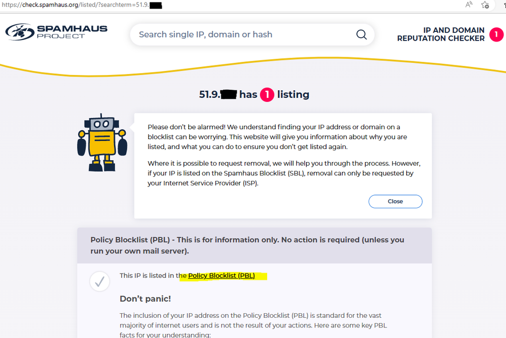

@LeeCal What list do they claim you are on? If you use the check link in post 2 what does it show for your own IP address. It is perfectly normal to be on the PBL, most residential ISP addresses should be:
For example, I am on the Policy Blocklist PBL as expected.

The policy blocklist, as you. I suspect Hostgator are misusing this listing. So far the dynamic DNS from noip.com seems to resolve the issue. I'm going to be moving away from them. Any suggestions to a good host that uses cpanel? I have GB of data stored and don't want to have to try a rebuild.
