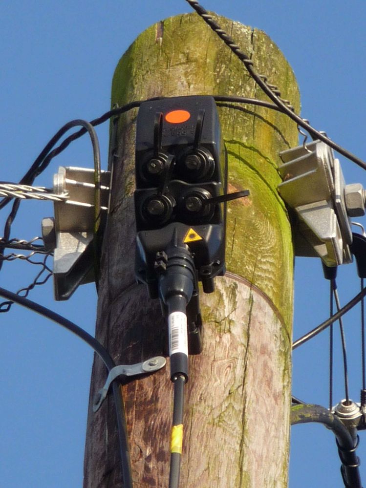

If the pole has been readied for FTTP it will have something attached to it that looks like this.
This is a Connectiorized Block Terminal (CBT). The number of ports will depend on the number of properties served by the pole.
From here a new fibre cable would be run to your house and brought down to a Customer Splice Point (CSP) attached to the outside of the house. The fibre is then brought in to an Optical Network Terminator (ONT) - this needs power. There is a bit of leeway as to where the CSP and ONT go but you would talk the the installer to see what's can be done to agree a location.
