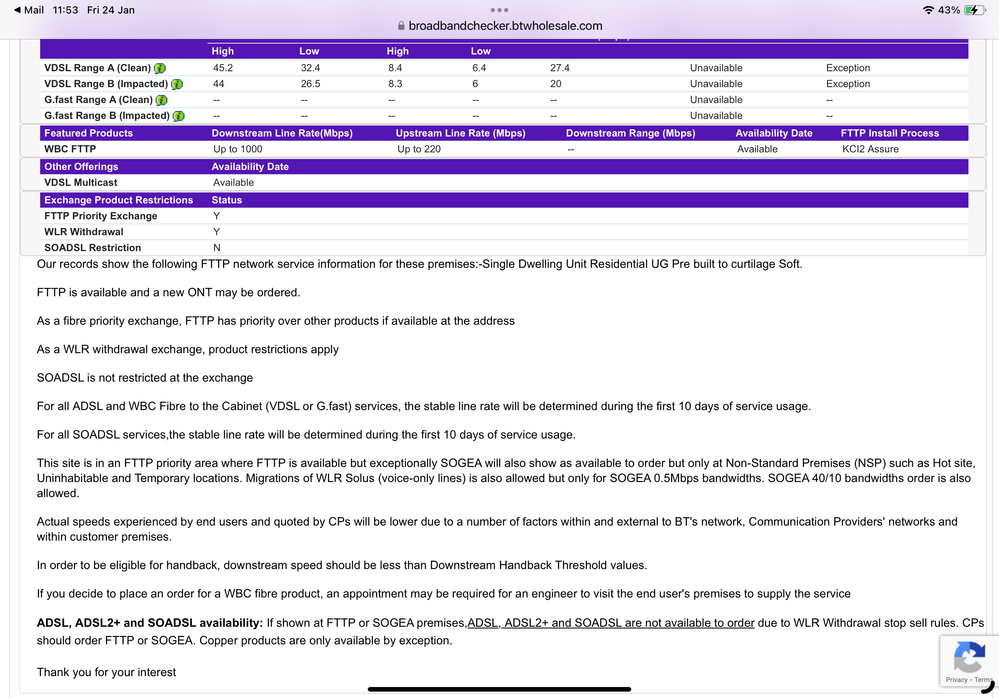

Melltt
Posts: 18
Registered: ‎10-12-2010
Re: FTC to FTP Upgrade Procedure
Not sure if this answers it?
mystreet1
Seasoned Pro
Posts: 453
Thanks: 226
Fixes: 7
Registered: ‎26-01-2024
@Melltt, think that it means this
The fibre cable is routing underground, however there is no duct in place to your property, and the existing copper cables are directly buried in the ground. There may be some works required to install a duct or the cable underneath grass (soft dig). Depending on the location of the works, this may require 3rd party permissions, local authority permits, and there are lead times with the planners and civil engineering teams. The installation could take a long time depending on the complexity.

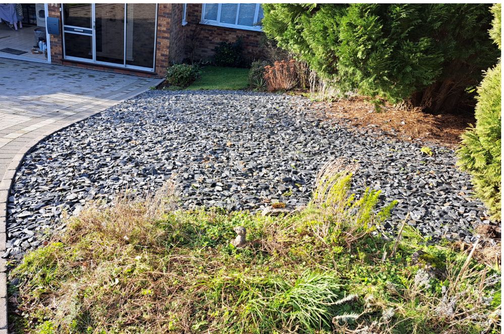

The marker in the roadway, presumably indicating buried Toby box.  Will have to drill through kerb to get into gardenThe marker in the roadway, presumably indicating buried Toby box. Will have to drill through kerb to get into garden
Route to house through rockery mound and under shale.  Existing underground BT cable at side of porch just past bush.Route to house through rockery mound and under shale. Existing underground BT cable at side of porch just past bush.
@Melltt
Thanks for the pictures. The disk may, or may not be a Toby Box.
I suspect they would still need to dig a small hole where the disk is to come under the kerb stone. They may be able to tunnel under or drill through if not. Apart from that, it looks like a straight forward trench dig with no tarmac or concrete to disturb. Easy to re-instate.
At the house a box would be installed on the external wall. This a called a CSP (Customer Splice Point). From there, the fibre cable is brought inside to an ONT (Optical Network Terminator) which requires power. There is some leeway as to where this goes. If possible, the installer will work with you on this.
The router is connected via an ethernet cable so can go anywhere you're happy to run said cable.
All in all it looks a pretty easy install. I suspect it would be done in two stages. An OpenReach ground works team would dig the trench (and probably install the CSP). Then the actual install could be booked.
