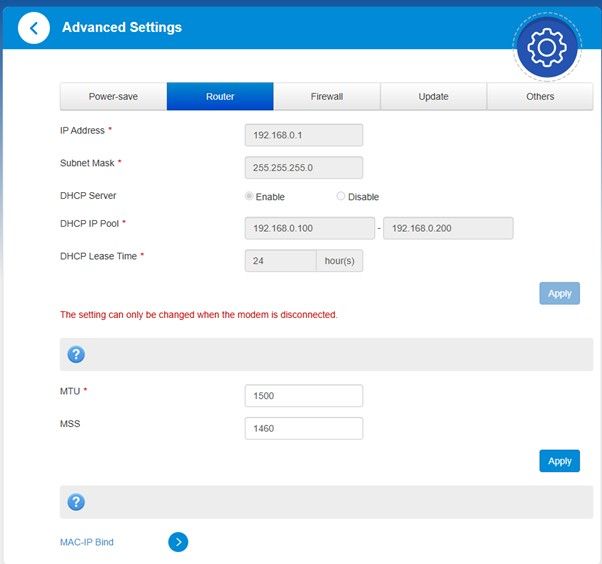

I have overcome that by changing the IP Address of the ZTE to 192.168.1.1 instead of the default  192.168.0.1, and hope I have set up the DHCP IP Pool correctly by again just changing the zeros to ones.

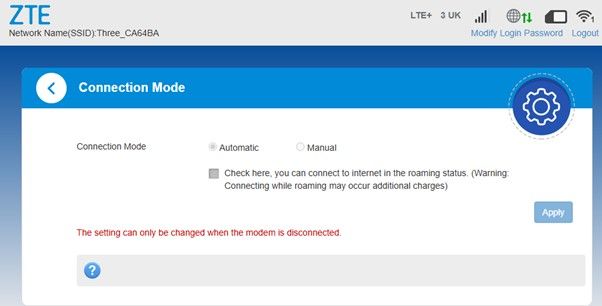

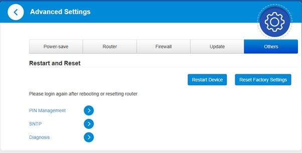

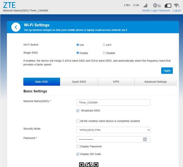

I still cannot see that option.
Here is my interface:
1-Modes.jpg2-Wi-Fi Settings.jpg3-Connection Mode.jpg4-Router Settings.jpg5-Firewall.jpg6-Advanced Other Settings.jpg
I have written to ZTE for an answer.

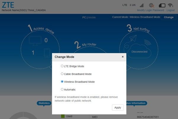

@RG58  your first image in reply #21 shows that you are in "Wireless Broadband Mode"
As @markhawkin said, it is unlikely that DDNS would work over mobile 4G as you won't have a public IP address (due to CGNAT), and therefore the ZTE might be hiding the irrelevant DDNS configuration menus in that wireless mode.
Try changing to "Cable Broadband Mode" to reveal the configuration options for the ZTE's WAN (FTTC) interface,
and then see whether the DDNS menus appear (as reply #18) - given that your Plusnet FTTC will have a public IP address.

The menu is still not visible in Cable Broadband mode.
