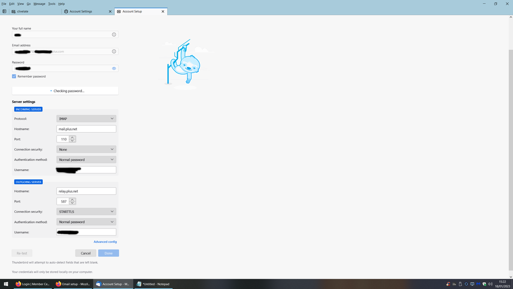

thank you, can anyone see anything wrong with these settings that i entered in thunderbird???

I can't see anything wrong there, but am rather concerned that TB is showing 'checking password'. Is this the same pw you have entered on webmail?

I'd suggest using imap.plus.net as the server, port 993 and security ssl/tls
Is this the primary mailbox or secondary ?
For a secondary one the username is accountname+mailboxname

Hi, i got it working now, i reinstalled thunderbird, entered the details, and it asked for password, i entered it, and it downloaded 20 emails, not sure what the problem was, but seems ok as i write.

I suggest that the problem was you were pointing an IMAP client configuration to the POP3 email server.
  • POP3 - mail.plus.net Port 110 (not encrypted) Port 995 (encrypted - SSL/TLS)
  • IMAP - imap.plus.net Port 143 (not encrypted) Port 993 (encrypted - SSL/TLS)
  • SMTP - relay.plus.net Port 587 not encrypted / encrypted (STARTTLS)
