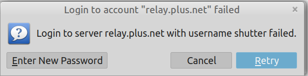

I can receive emails from plusnet... I can receive emails from my gmail address. but I cannot "reply to sender" nor can I write a "new" message from my .plus.com email address
get this messsage pane...
I do not use webmail. and have no desire or need to do so....... I use Thunderbird.

@shutter I've just tried, and sent successfully, so I suspect it is smething local to your setup. Presumably this is a new issue?

@jab1  on webmail login failed...
 I recently changed my password to login on the forum..... BUT.. even if I use my "old" password, it still reports "login failed"
Just as well I use Thunderbird ! .

@shutter your forum password has nothing to do with your account password. Sounds to me like you're using the wrong password especially as webmail login fails

Also, if my password is wrong ( which it seems to be ! )  how come I am receving emails on plusnet email address.
2nd question, How do I change my email pasword, if I don`t remember the one I put in 15 years ago  ?
( or changed at any time during the last 15 years )  ?
I don`t remember changing my email password recently,  and it  ( plusnet email was used to send an email on July 6th 2022 )

Are you using the main account login or a mailbox login to receive ?

@shutter your password doesn't affect incoming mail - it is only required for outgoing, to prove to the system it is you

@MisterW   don`t know.... as I said before... I don`t use webmail.  I use thunderbird,... and as far as I don`t remember any password changes apart from my pn user login password.
would it be something I need to check on the pn profile page for email settings ?

@jab1 a correct username & password is required for incoming mail . However, often, the incoming mail is from a secondary mailbox and has the account+mailbox username format and the mailbox password which is different to the main account password. Usually the main account name & password are used for smtp authentication , although the mailbox format & password can be used
@shutter earlier you said youd changed your forum password now you say it's the pn user password. Which one is it ?
