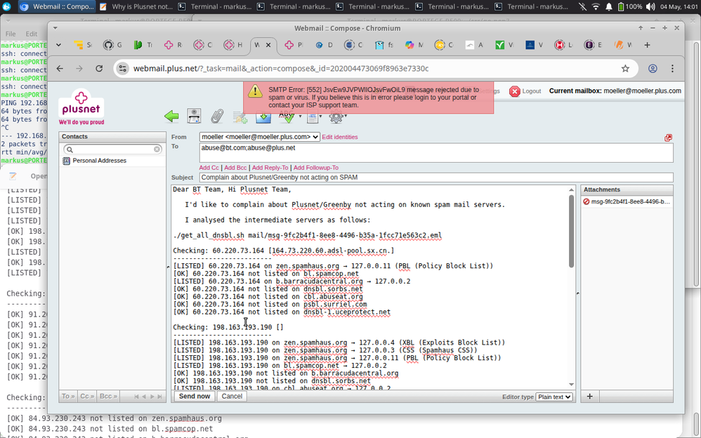

Trying to complain to abuse@plus.net I get blocked. I complaint to OFCOM as they must accept these emails.
Re: Spam tsunami
3 weeks ago
It seems also my postings get blocked. I had posted this:
Which did not appear anywhere.

I need to post as image as it gets removed. ( this was message 10 under this subject as you can see on the bottom of the image )

[LISTED] 198.163.193.190 on zen.spamhaus.org → 127.0.0.3 (CSS (Spamhaus CSS))
[OK] 198.163.193.190 not listed on bl.spamcop.net
[OK] 198.163.193.190 not listed on b.barracudacentral.org
[OK] 198.163.193.190 not listed on dnsbl.sorbs.net
[LISTED] 198.163.193.190 on cbl.abuseat.org → 127.0.0.2
[OK] 198.163.193.190 not listed on psbl.surriel.com
[LISTED] 198.163.193.190 on dnsbl-1.uceprotect.net → 127.0.0.2
