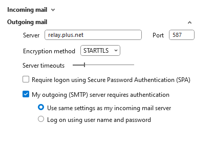

Certainly in the first instance try to get this working with username and password but WITHOUT encryption.  The settings should look something like...
