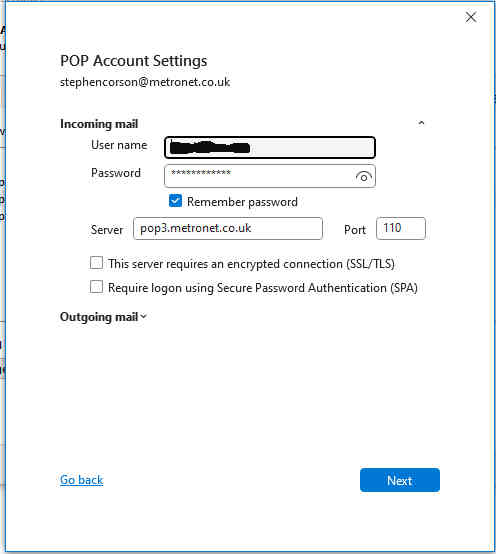

@cor123
Note the correct server settings for Metronet...
Brand: Metronet - encryption supported: No
  • IMAP: imap.metronet.co.uk port: 143
  • POP3: mail.metronet.co.uk port: 110
  • SMTP: smtp.metronet.co.uk port: 587
Your screen shot has the wrong server for POP3 ... though that might not be the only problem.

Re: SMTP problems??
Following on from what Townman says, can you also check the username format. It looks a bit short in the screenshot.

Tony From Metronet member center summary mailbox
Posts: 29,348
Thanks: 13,476
Fixes: 251
Re: SMTP problems??
Are you using your email address as the username?  If not, try it.
