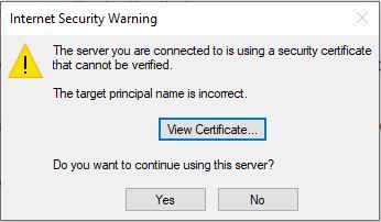

Now getting this certificate installation popup which when installed does not resolve the issue.

Check the certificate details, specifically the server names.
Plusnet servers tend to be a bit bipolar to deal with presumptive clients. Consider first example Plusnet’s core SMTP server…
Real name: relay.plus.net
Client presumed name: smtp.plus.net
Without encryption either will work fine, but with encryption the latter will give rise to a certificate error because the presumed name is technically wrong.
The server detail in the certificate identities the correct server name.
