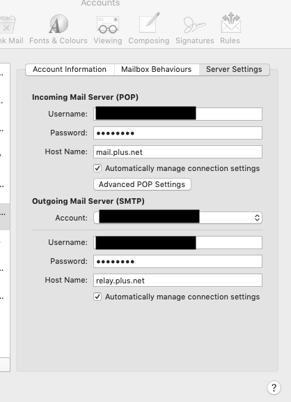

17-09-2025 6:47 PM
The issue I have is If the settings are managed automatically I can't tell how it's configured - apart from an expert like yourself being able to tell what port was being used from the log info I provided.
I'm reluctant to start fiddling with settings (I haven't dared uncheck the Automatically manage setting box) in case it breaks something. And also we were advised elsewhere not to change things at the client end as it would hinder investigation of the issues.
If I've misunderstood and someone can advise on what I could/should do to be 'compliant', here's how my account configuration looks at the moment. (MailServerConfig snapshot.jpg attached)

17-09-2025 7:31 PM
Which email client is that?
The server names are correct, but port numbers and encryption are not shown. One will just have to hope that the client's guess work is correct!
