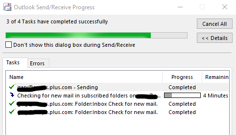

Re: Outlook downloads emails to subfolders, but not to Inbox
No joy, though for some reason now there are multiple mailboxes being checked, despite there only being one account. These three with ticks are all the some account.
I went back to my other PC and moved all emails in the Inbox to a subfolder called _Older. Switching back to the laptop I can now see messages in the Inbox, so it looks like Outlook was timing out on refreshing the folder. I have set the refresh time to the highest possible (4 minutes) and there are now around 250 messages showing in _Older out of about 2500 actually in there. How can I manage the rest if they don't download from the IMAP server? I've got recent messages from Plusnet about my mailbox being 75% full, but if the folders don't sync reliably it's kind of hard to fix.
@Useless - If this isn't a recent issues relating to our email issues over the last few days, I suspect the issue is relating to our long standing issue that affects mailboxes that are heavy. The principle is that at peak times and with a heavy mailbox be it a lot of small emails or large ones, they don't come though. Same with webmail timing out and getting failed to send fetch commend if you've ever had that.
The trouble with changing the refresh time is that if the sync fails it a while before another. The best thing I can suggest is to go on webmail and clean out the mailbox so that they sync properly.
Hello James,
I think you are right about the heavy mailboxes. In the end, I created subfolders on my PC and gradually moved emails from Inbox into those, so that the size of the Inbox itself got smaller. I then deleted as much as I could from the subfolders. Eventually things started to improve! I'll close the call now, as I don't think there's what might be called a 'solution', for this, just a workaround.
