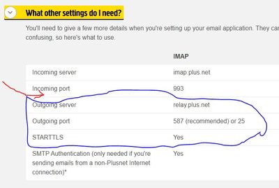

Initially I could not understand why you could not follow the instructions ... until I DOUBLE read your update...
The configuration details are not complete, the encryption settings (STARTTLS) you used are under the OUTGOING server settings (blue box).  The encryption settings for the INCOMING server are missing (red arrow).
@JonoH
Are you able to request an update to this user guide please?
  1. Add the encryption setting for the INCOMING SERVER
  2. Change the presentation of the information, so that the settings are clearer, as in...
    • Incoming - Encryption: TLS/SSL
    • Outgoing - Encryption: STARTTLS
(2) is more aligned with what the user needs to do / know - they are setting ENCRYPTION as required, not setting STARTTLS to "Yes".  There might be merit in totally reviewing this page to specify the three server options separately, so as to achieve what the narrative seeks to do - remove the confusion.
  • Incoming (POP)
  • Incoming (IMAP)
  • Outgoing (SMTP)
The out going server is the same regardless of the choice made for the in coming server.  To infer any conjunction between incoming and out going only serves to confuse ... as does stating caveats as to when / if SMTP authentication is required.  KISS - just always specify SMTP authentication ... it avoids both confusion and later support calls ... "I cannot send emails ... works OK at home ... but not at my mate's house".
