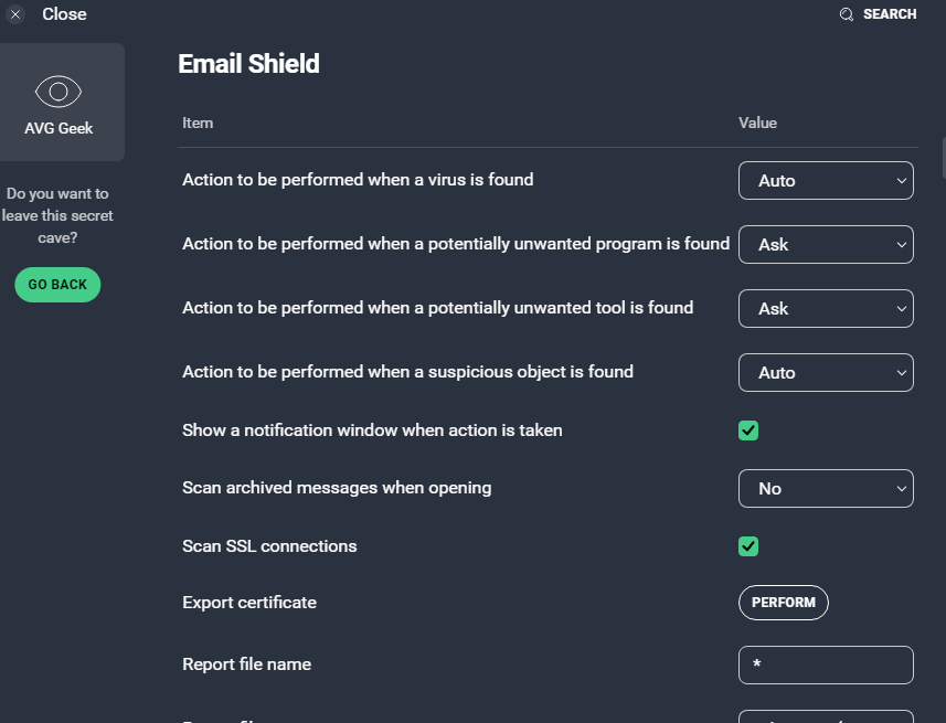

This may be useful for AVG users:
Go to the AVG client's Menu > Settings. Search for "geek:area"
You can disable AVG's man in the middle SSL
