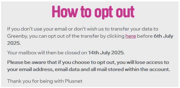

11-03-2026 5:06 PM
[-Censored-]!
I never received this or any other email from Plusnet warning of these changes!
