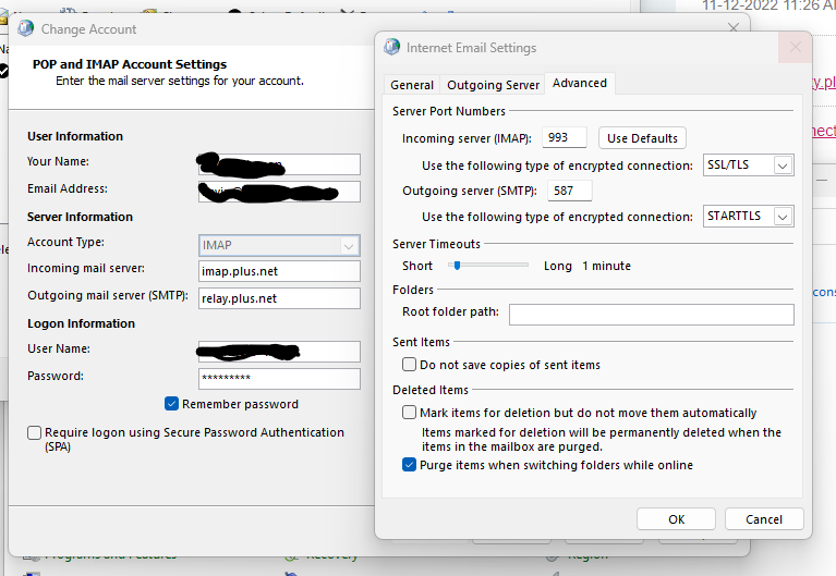

I have tried several settings the best one being as in pic below, this just gives server timeout. Using office 365

The outgoing server requires STARTTLS as well as the incoming server.

Re: Frustrations of Getting Plusnet Emails via Outlook
The email setup help page is deeply confusing - I have made multiple requests for it to be corrected.
Incoming - imap.plus.net port 993 encryption TLS/SSL
Outgoing - relay.plus.net port 587 encryption STARTTLS
Outgoing server should use authentication - same login details as the inbound server.

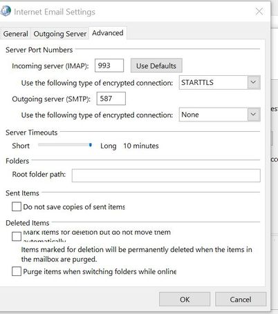

@Townman I have tried your suggest settings and are still getting server timeout even if I set timeout for max period 10 mins.
