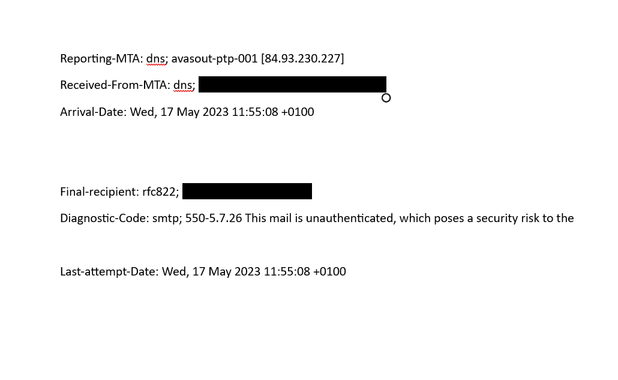

Emails to GMail accounts being rejected
I am getting what appear to be similar rejections to some that have been reported in other posts, when sending to gmail addresses.  The message suggests this is something to do with verification issues mentioned in other posts (e.g. https://community.plus.net/t5/Email/Blank-Error-Message/td-p/1859134  from Feb 2022), and I am wondering if my practice of using the "sent from" option in desktop Outlook is causing this issue.  The message I'm getting:  2023-05-17 (2).png
Like some other users whose posts I've seen, I have been using my Force9 account for many years to send and receive emails for a domain I use, that doesn't have a .f9.co.uk name.  Emails to that domain are all forwarded to my Force9 address, and I send via relay.force9.net.  In my cases, the rejecting server appears to belong to Plusnet, I assume as part of the AV system, but the fact that this is only just happening suggests to me that something has changed.  The incompletely-formed error text is also a puzzle.  Can anyone help?

@iainmackay, the rejecting server is the one you've blanked out.  The Plusnet server that is listed is the reporting server.  ie Plusnet server has created a connection to the one that is blanked out and sent it some info.  That other server has then rejected the message.  It is then for that other server (the Plusnet one listed in this case) to report that back to you.
The issue is that Google have made changes so that at least some of the messages have are rejected if there isn't SPF or DKIM records present.
One "solution", as detailed above, is to create an SPF record for your domain.

iainmackay
Posts: 19
Thanks: 4
Registered: ‎07-08-2007
Re: Emails to GMail accounts being rejected
Ah!  Sorry @pjmarsh , the blanked "server" is my desktop PC, which is why I blanked out its details.  This implies that it's my own instance of Outlook desktop that's refusing to send my email?  @Baldrick1 , that makes sense but for the fact that the message seemed to be coming from my own PC...  I have sent you a pm with more details in the hope you can advise me.
@Browni that is the way my Outlook account settings are, specifying relay.force9.net on port 587.
My domain is hosted by fasthosts, with all emails forwarded to my Force9 address.
This is beyond my cunning, so can anyone suggest what I need to do?
So in summary, you are using Plusnet's SMTP servers to send email from a third party domain name to Gmail?
If that is the case, you will fall foul of various non-mandatory standards imposed by Gmail...
  1. The connection to the SMTP server (relay.plus.net) MUST be authenticated - if your device is connecting over the Plusnet network, you can send emails without using a username and password, but some receivers will not accept emails sent in that manner - see the response from @Browni
  2. The sending DOMAIN must have a SPF record indicating which SMTP servers are valid for the domain name - this you should be able to set up with your domain name host service in their DNS configuration
  3. The sending service should use DKIM - this is not something you can effect using a third party domain when using Plusnet's SMTP relay services - HOWEVER if the sending address is mailbox@account.plus.com DKIM signing will be applied
Frankly hosting a domain on a third party environment, forwarding inbound mail to another hosting provider and than expecting to email to Gmail with out issue is a somewhat forlorn expectation!  One should always use the SMTP service associated with the domain's MX server.
